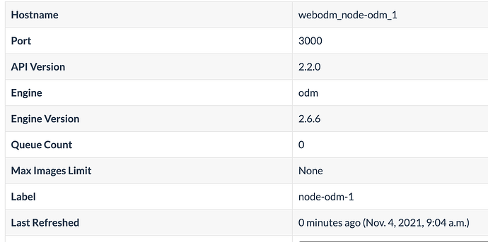

Still having issue with geo.txt on WebODM.
I upload with the images (using “select images and GCP” button) the geo.txt file and am getting
[INFO] Wrote images database: /var/www/data/369971ac-b893-4f7e-96cb-17de0f734bb3/images.json
[INFO] Found 7 usable images
[WARNING] Could not generate coordinates file. The orthophoto will not be georeferenced.
I also tried to not upload it to WebODM and leave it in the images folder hoping it would be recognized somehow - but same result.
I only tried a few images to see if they get recognized - hence the short list.
Is it something in the formatting? or they way I upload to webodm?
Tnx !
This the webdom processing node configuration
This is the actual geo.txt

I think you’re running an old version of the software that doesn’t have support for geo.txt. Try upgrading to the latest.
Tnx @pierotofy
Upgraded with ./webodm.sh update and got
Pulling node-odm ... done
Pulling db       ... done
Pulling broker   ... done
Pulling worker   ... done
Pulling webapp   ... done
Done! You can now start WebODM by running ./webodm.sh start
This is the updated version I got
Still getting same error:
