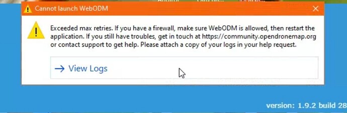

On running now I am getting these errors
Screenshot_20210710-162905_Remote Desktop|690x323

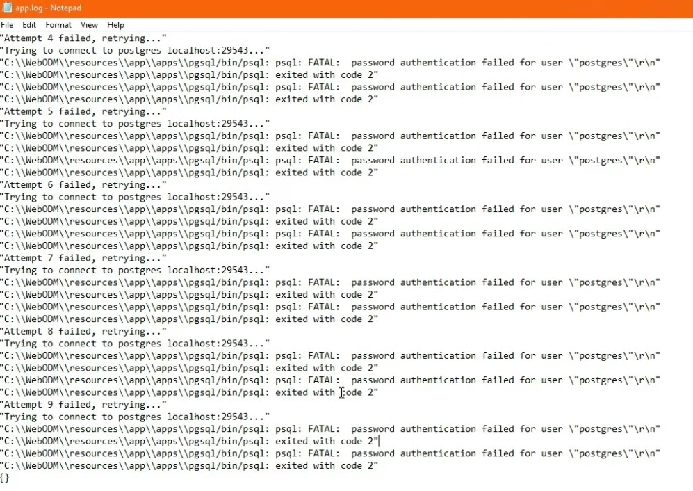

And the log shows stalling at postgres authentication and timing out

Still won’t run. App log:
“Attempt 9 failed, retrying…”
“Trying to connect to postgres localhost:29543…”
“C:\WebODM\resources\app\apps\pgsql/bin/psql: psql: server closed the connection unexpectedly\r\n\tThis probably means the server terminated abnormally\r\n\tbefore or while processing the request.\r\n”
“C:\WebODM\resources\app\apps\pgsql/bin/psql: exited with code 2”
“C:\WebODM\resources\app\apps\pgsql/bin/psql: psql: FATAL: the database system is in recovery mode\r\n”
