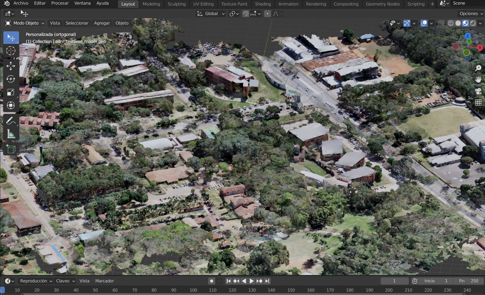

I try it with the 3D Model default option:
Processing options: auto-boundary: true; mesh-octree-depth: 12; use-3dmesh: true; pc-quality: high; mesh size: 300.000; resize image: yes - 2048px.
Processing Time: 1.0h:5.0m:43.0s
This is the result
Is there a way to close those gaps in the model?
and improve the quality of the 3d model without using so much ram memory?
That mostly depends upon the quality of the input data and survey method.

Maybe try a new preset based off of Default adding/adjusting these parameters:
--feature-quality ultra
--min-num-features 32000
--pc-filter 0
--pc-quality ultra
Some spots on the report show really low counts of being visible in multiple images. It is possible those areas are in really high-contrast/low-detail regions (shadow, specular/highlight), and if so, there isn’t terribly much you can do without trying to pre-process the data, which is tricky.
