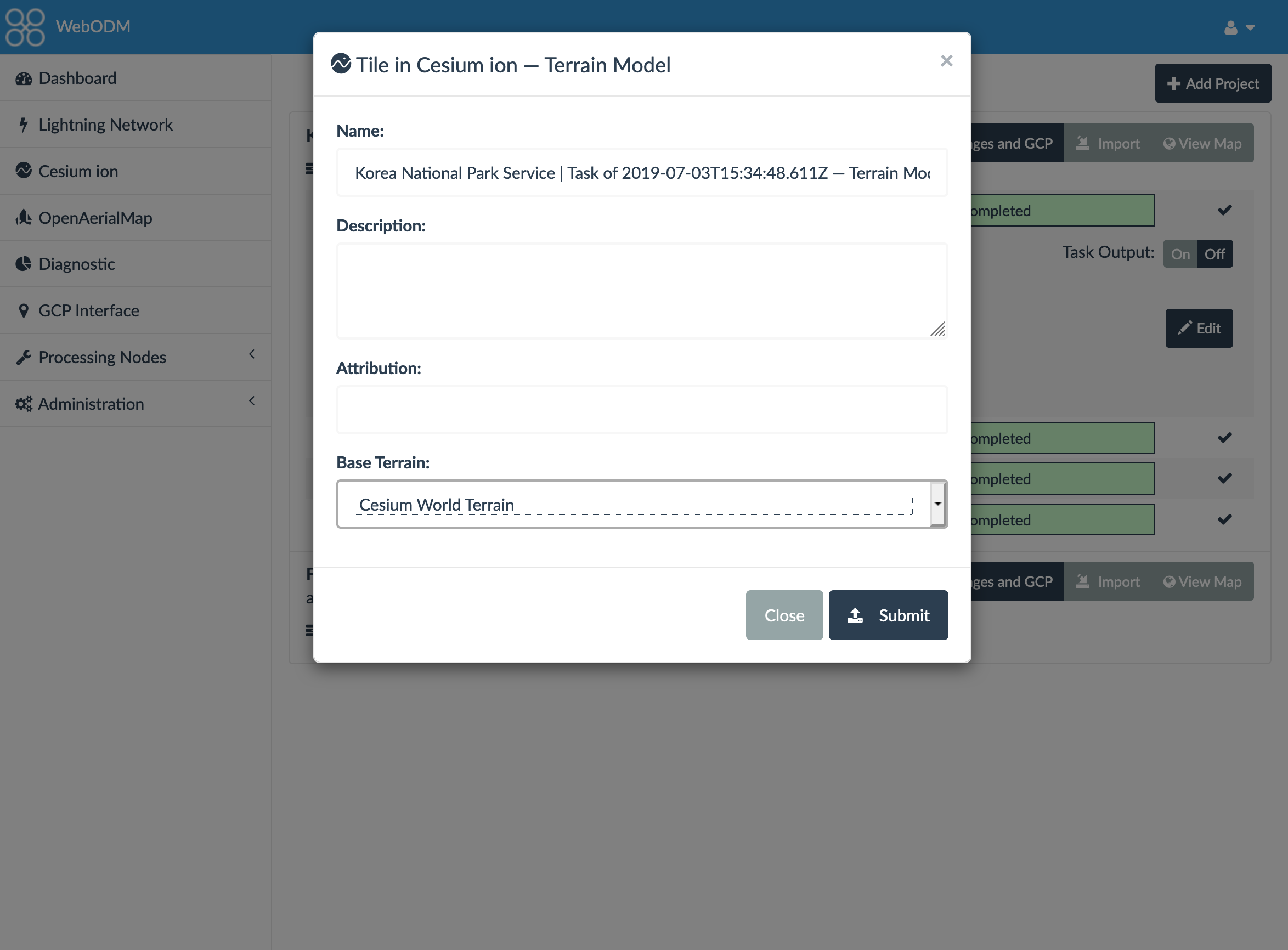

Here are some screenshots from the latest version:
FUTURE VERSION PREVIEW:
