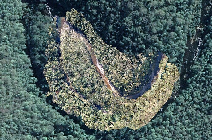

I’ve been experimenting with a few different settings on webODM for mapping both complex evergreen forests and rivers, with some decent results. But I’m yet to find a set of settings which don’t have warping issues or mismatches. Comparing to DD, WebODM does a good job but seems to show some inconsistencies no matter what settings I try. Flying with a 75% front and side overlap at 150m.
My biggest issue is that with webODM, vegetation seems to be stitched into areas of river no matter what settings I try. Any ideas on whether I can get a better set of webODM settings for a similar output to DD (will post in comments as I am not able to add more than one embedded image as a new user)
https://drive.google.com/drive/folders/1U0rhwqkjyS9Wzz8N5Mnfr4Uu4Z2fc3Kf?usp=sharing
WebODM - dem-resolution: 2.0, dsm: true, gps-accuracy: 1, min-num-features: 15000, orthophoto-resolution: 2.0, pc-quality: high, use-3dmesh: true
DD output for comparison - note that the DD output shows all areas of river and back channel and doesn’t have the same gaps/warps in the ortho.

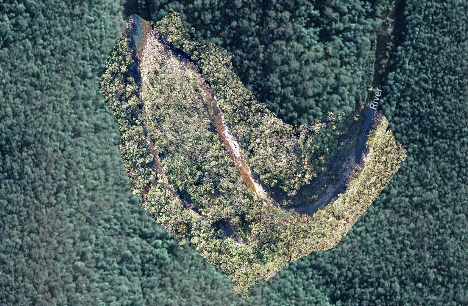

I’ve tried using fixed camera parameters with the following output - slightly better output in some areas but still some issues with capturing the whole river.
Settings - dem-resolution: 2.0, dsm: true, matcher-neighbors: 16, min-num-features: 12000, orthophoto-resolution: 2.0, pc-quality: high, use-3dmesh: true, use-fixed-camera-params: true, rerun-from: dataset

https://crankyserver.com/public/task/6458664f-7a78-4095-a083-08ce1b2441d8/map/
auto-boundary: true, dsm: true, feature-quality: ultra, pc-quality: ultra, rolling-shutter: true, rolling-shutter-readout: 56,
I also recommend trying the “fields” drop down setting. Your sidelap is pretty low for a forest area, so true orthos can be a challenge, but planar estimates (which is likely what DD if failing back to here) may look better.
Here’s what it looks like for me using ultra/ultra:
63 images 02:34:35
||auto-boundary: true, dem-resolution: 2, dsm: true, feature-quality: ultra, gps-accuracy: 6, mesh-size: 250000, min-num-features: 15000, orthophoto-resolution: 1, pc-quality: ultra, resize-to: -1, use-3dmesh: true|

Thanks for this smatehrmather. I think you may have solved it with the planar estimates, I’ll do a re-run now but from your version it looks like most of the issues have been corrected. I’ll upload a side-by side of any areas I have issues as I understand it’s difficult to compare - I couldn’t do that initially as a first time poster.
Good to know about the planar estimates - it can be difficult to get a flight with good (over 90%) overlap without massive battery use in some of the remote forest settings I map and having used DD for quite a while now I’m guessing that’s what they revert to with their recommended flight path settings.
