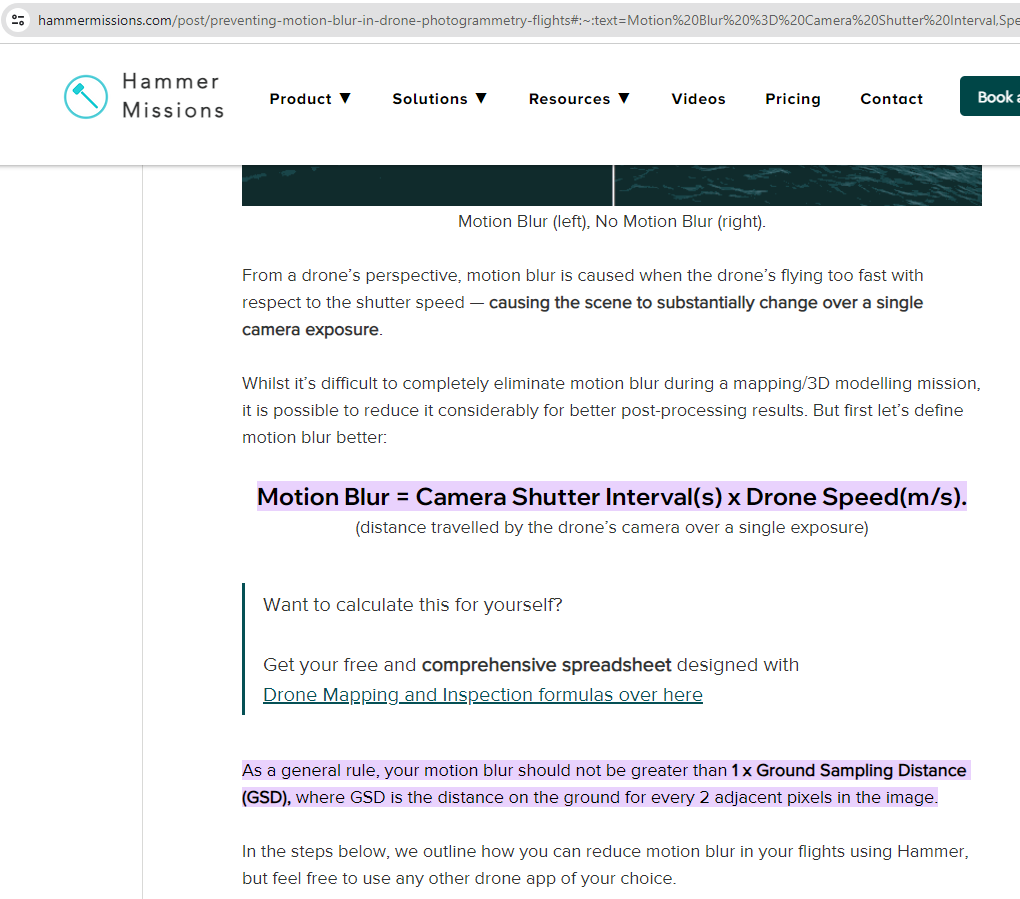

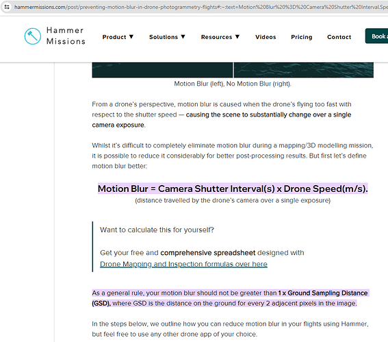

This is the article I remember reading on this topic:

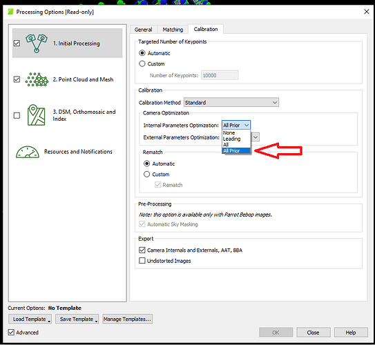

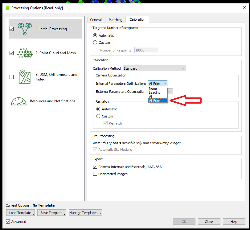

The Mavic 2 Pro has certainly been an interesting camera to figure out.
For example, using Pix4D, I discovered I needed to use this option to show a good calibration in the Quality Report.
I haven’t dug too far into the WebODM camera calibration options and reports - but I wouldn’t be surprised some adjustments are necessary for this drone’s camera.
