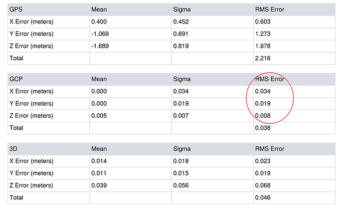

So good news, following @YanNoun suggestion I’ve pushed an update to ODM which decreases the default GCP deviation, reprocessed this dataset and got some good results:

This look like really interesting stuff. I wonder does OpenSFM log similar statistics (mean, sigma, RMS error) on each GCP?
This is how Pix4D shows it and its very useful to find GCPs which are skewing the overall result and offers the opportunity to rerun with more / or less GCPs.
This would allow the opportunity to add in check points to the GCP file rather than keeping them in reserve for manual checks.

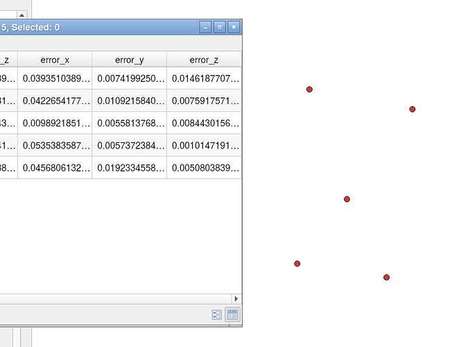

You can find per-GCP error measures by opening the ground_control_points.gpkg file in QGIS (from the Attributes Table window):
