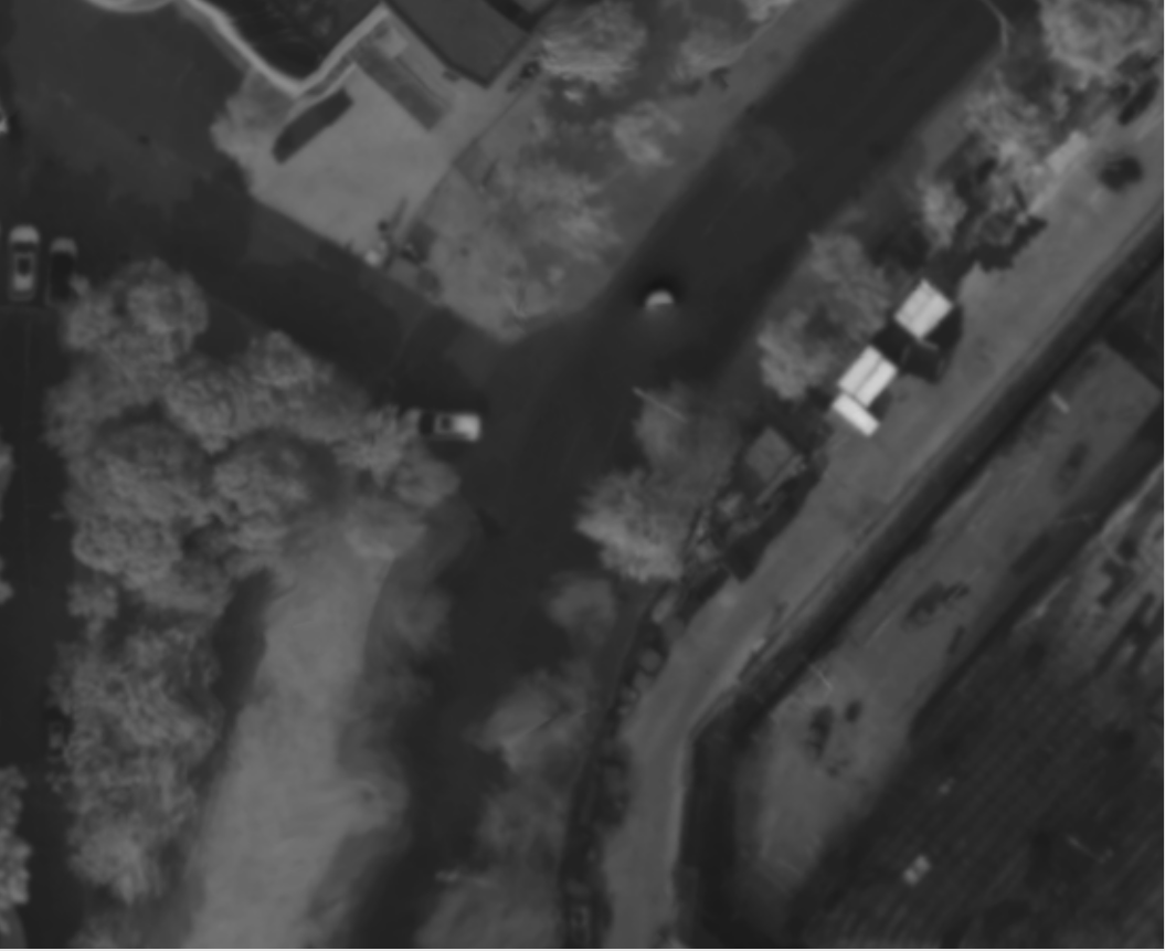

Hello! For multispectral orthophoto, every band images can be textured for the same mesh and compute orthophoto of every band in ODM. Every orthophoto is aligned. But I found a problem! Due to the mvs-texturing, there is no guarantee that the image content is consistent everywhere. For example:
Red band orthophoto:
NIR band orthophoto:
In this red band orthophoto, there are two more cars. And the ndvi idex is error .
Can anyone give some advice? Is there a paper or book recommendation for calculating orthophotos?
That’s a really good point; you can disable outlier removal by setting --texturing-outlier-removal-type none.

Thank you very much for the discussion! I found that ODM can make good use of mvstexturing’s labeling_file. The data_costs and view_selection is calculated only once in the Green band phase.
