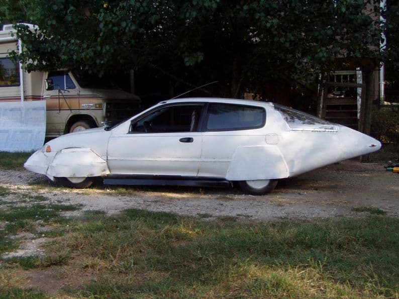

I’m unlikely to do anything extreme with the back end, though I have been enjoying https://ecomodder.com/, but no boat tails or anything too extreme for me just yet:
ht: https://www.aerocivic.com/
